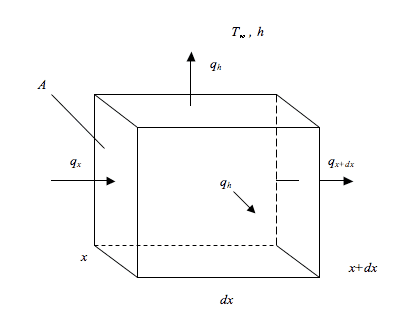

I am trying to derive a finite difference scheme for 1-Dimensional conduction and convection. I am using a similar approach to one used in my lecture notes for conduction only. It is a control volume approach to this.
I would upload a picture, but I think the 1D case is simple enough to picture. Picture a bar with constant cross-sectional area. We will work with a cross-sectional "slice" of the bar whose length is dx
EDIT: Picture added
So as said, there is conduction occurring (i.e. a temperature gradient is present) and there is convection going on. Here are the properties of the bar [with dimensions]:
A = constant cross-sectional area [Length2]
K = thermal conductivity [Power/(Length-Temp)]
c = specific heat capacity [Energy/(Mass-Temp)]
h = convective coefficient of heat transfer [Power/(Length2-Temp)]
[itex]\rho[/itex] = density [Mass/Length3]The Energy balance is given by:
[tex]E_{in} + E_{generated} = \Delta U +E_{out}\qquad(1)[/tex]
There is a conduction term on the left edge of the control volume at x and a conduction term at the right edge at x + dx
That is, the energy balance becomes:
[tex]q_xA\,dt+QA\,dx\,dt=\Delta U+q_{x+dx}A\,dt + q_hP\,dx\,dt \qquad (2)[/tex]

[itex]q_x[/itex] is the heat conducted (heat flux) into the control volume (CV) at the surface edge x.
[itex]q_{x+dx}[/itex] is the heat conducted (heat flux) out of the control volume at the surface edge x+dx.
Q is the internal heat source (or sink); heat generated (or removed) per unit volume.
[itex]q_h = h(T-T_{\infty})[/itex] is the convective heat transfer
P is the perimeter around the constant cross-sectional area A

it made me go back and look at what we are doing. Looking at the differential element in the picture, we have 2 conduction fluxes. We were able, through some cancelation of terms, to relate both back to a single temperature gradient. But the convection term is kind of whacky. It relates the convective heat transfer via the whole element to the ambient temp and one single temperature inside of the element. But we just said that there must be a gradient else there would be no conduction.
Do you know what is going on here that I am missing?
There is one single temperature for each element (in the differential limit of zero element width, no gradient can exist within the element). The gradient only exists as a difference in temperature between any particular element and an elements on either side. Furthermore, these two gradients (the one between the center and left elements and the center and right elements) are not necessarily equal. If they are not equal, then the temperature of the center element will change with time (ignoring convection). I'm not sure if this answers your question?
EDIT: I should add, the conduction term is not a single gradient. It is the gradient of two gradients, the one on the left and the one on the right. That's why there's a denominator of [itex](\Delta x)^2[/itex] rather than just [itex]\Delta x[/itex].
Also, I just saw your question about convection on the ends of the bar. Although this isn't addressed by the differential element analysis and resulting governing equation, it is addressed by the boundary condition at either end of the bar, which would be, for example,
[tex]\dot{Q}=hA[T(x,t)|_{x=L}-T_\infty][/tex]
or, applying Fourier's Law,
[tex]-kA\left[\frac{\partial T(x,t)}{\partial x}\right]_{x=L}=hA[T(x,t)|_{x=L}-T_\infty\mathm{.}][/tex]
